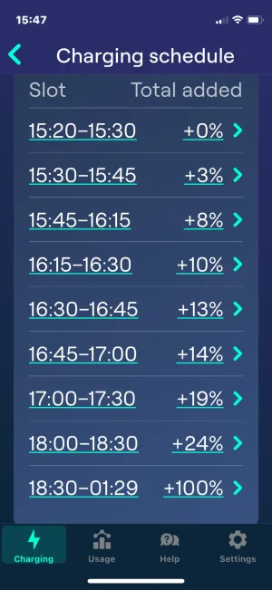

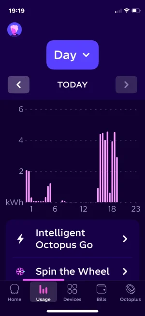

Ours never shows cost until the bill - I think its down to the meter brand. We are relatively high usage users (Nov 25 month was 1400kwh) the good news is that from todays bill, as long as the car is plugged in and charging then the rate is 7p for both the house, battery & car, as its always been (its never failed todate). Today I'd been away so only had 10% battery, and plugged in around 15:00 (my default is ready by 05:30am, charge upto 25Kw at 3.67kwh) and it did exactly what I asked, albeit it finished around 19:30 (with a short break 18:00-18:30 as the schedule noted) - it also correctly detects when I'm charging the home battery, without the car plugged in.

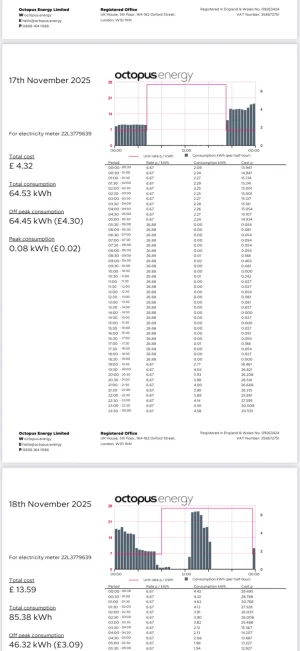

I received my bill yesterday and always use well over 6 hours every time I plugin (unavoidable with the max speed of my Ohme being 2.25Kw real world). It’s always low rate for me when Octopus manage the charge.
