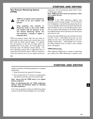

several years past from the beginning of this topic, so what's is final answer on the question:
Does MG4 autotune TPMS position if wheels were mixed? If it does not do it automatically how to reset it from menu\engineering menu\special procedure?
This is the latest that has been mentioned.
Funnily enough the last word on the previous page shown above is the “some”. So it appears some MG4s can self learn, but others cannot. I wonder if that is down to vehicle software version or perhaps the use of different sensors in the valves.
Also, driving continuously at 30 km/h plus for 15 minutes is pretty much impossible in any city, but I guess they mean without turning the car off.
Nice, this "some car" sounds "very promising" 😂

Would be interesting to find out - manual also has this
But... my FL5 manual notes the wheels can be swapped diagonally and sensors will self-learn under the respective section for same.
So the "learning" procedure mentioned before may just be pressures and not positions. 🤔
