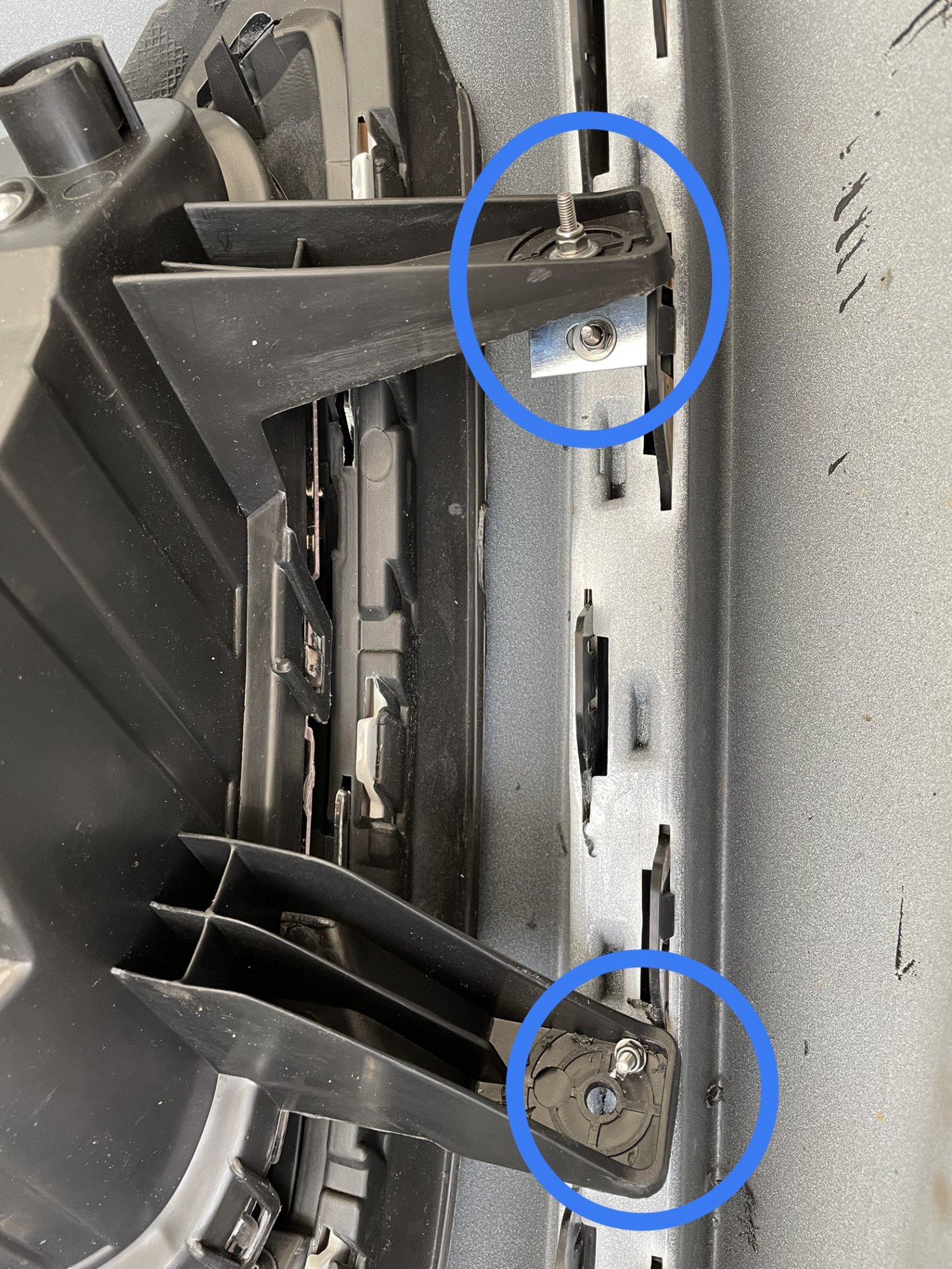

Bumper removed
1 Zip tie the charging point door shut
2 remove the two screws from the rear of the grille insert
3 un clip the chrome piece first and remove it from the front of the bumper
4 un clip the grille and remove from rear of bumper
5 clip in the black cover from the rear of the bumper
6 clip in the chrome piece from the front of the bumper and insert the two screws remove earlier
6 as you can see from the photos below there are no fixing points for the fog lights
I used small self tapping screws for the top fixings
And small nuts and bolts for the lower ( I un clipped and removed the small black plastic piece to gain access for the nuts and bolts)
View attachment 8615View attachment 8616View attachment 8617
