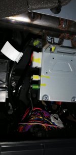

I have attached a photo with the plugs out. Bottom one is USB.
Which one do I disconnect and how do I do this because they. Are all very tightly fastened

Looking at the picture it’s the usb connection, to me it appears to be the cable with the white tape on the cable.
I would add that if it doesn’t come apart easily I’d suggest you get it back to MG as I had this problem and it only took them 5 mins to sort it...
you must have the top widest there you also see the red plus wire the other two are antenna cables
