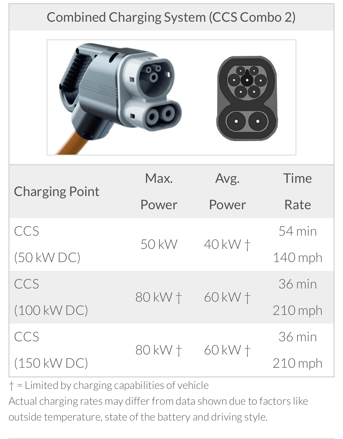

No - it doesn’t I’m afraid. The Long Range and Standard Range both have identical quoted charging speeds of 80kWh
For marketing reasons (and perhaps availability of units), the Standard Range seemed to quote speeds on a 50kW unit whereas the figures for Long Range quoted a 100kW. But they both do 80kWh.
It is of course entirely possible that EV Database is wrong ?‍
Standard Range:
Long Range

But as proven above it was doing more than the advertised 80kW. (in the photo 86kW at 45% SOC, quite impressive)

Yep - I have a suspicion that the unit displays the power it draws, not the power it provides to the car so you're being charged for any losses in the process. 86kWh is a 7.5% loss (compared to 80kWh) to AC->DC conversion, heat, etc - which sounds plausible? Or maybe the 80kWh is an average figure and it can peak a little higher. But, both he SR and LR will charge at the same speeds of (approximately) 80kWh. I'm speculating a touch on this based on the quoted figures.
These are the best numbers I’ve personally seen - averaged 65kWh from about 24% to 86% - peaking at over 80% (from memory as not shown on the final summary).
I should add - I'm not precious about this, if someone gets more that 80kWh (plus conversion losses) then superb, as we should all be able to achieve that - this will only happen on 150kW+ unit (equates to 120kW for 400V cars) as even the Osprey 120kW will only output around 80kW for our 400V MGs. Will check again in July when graphing though ABRP OBD connection.
Confirmed by esteemed MG dealers I'm afraid, I did contact EV database about their error but they are yet to correct it. 92kW in France ??
