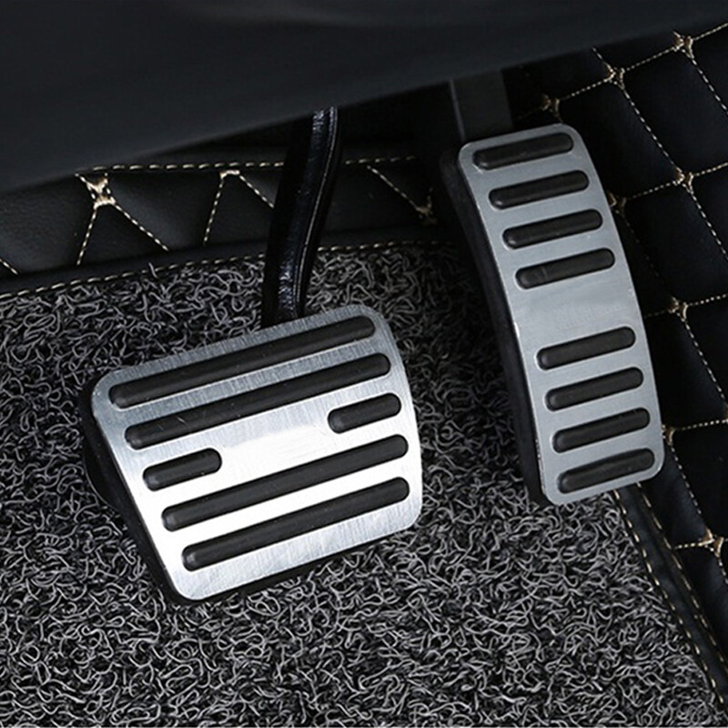

Can you post a pic of the auto brake switch you refer to. I don't see anything like that on any of the menus.
As you wish (It's the one on the left of this pic)
It's when you hold down the brake pedal until the green (A) appears on the dash.
