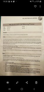

It sounds like you had the faulty BMS update which degraded your battery voltage and therefore range capacity. I had same issue when I bought my car in Dec 20. MG released a new software update on 15th January and again in February 21. If the dealer has just updated the software but not helped your car charge and balance to get you to a new fully charged voltage of 449/450v then it will take a good month or so of constant charge/balance cycles to get your car back to normal voltage and actual range.
Your regen warning is because car battery is fully charged and has no space to put regen charge. This is normal but you will find your regen will kick in quicker now with new BMS as new buffer added to capacity.
Also your slow charge warnings will go once you get battery back and balance/equalisied charged.
Useful video on topic here
MG uk have even issued guidance to dealers to get car to a voltage range minimum before giving customers car back to them.

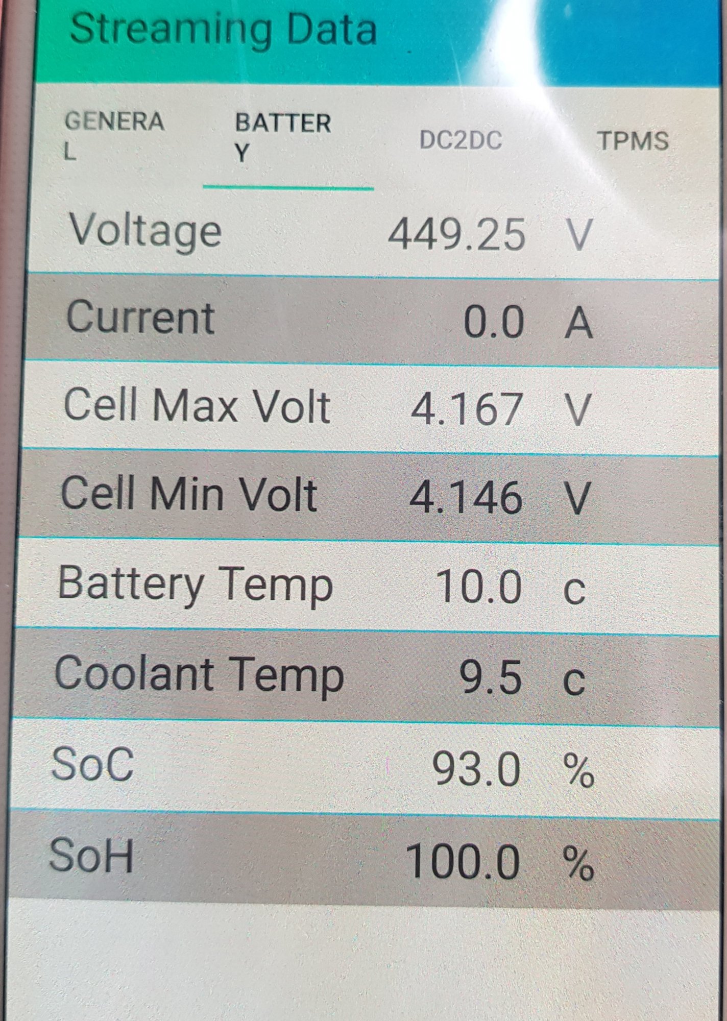

I ran my car down one blob and then charged (MG badge pulsing) and left to balance (MG light on whilst balancing and off when complete)
Found it took from over 10 hours to balance and now after a month of constant charge cycles it's on around 2 hours to complete and at 449v with an improving variance of cell balance between lowest cell and highest.
Use AC home 7kw or granny charger so it does a balance at end of top up charge from about 85% (one blob on dash)
Worth getting a OBD dongle and one of the Apps such as car scanner torque Pro or Thai free app on this site.

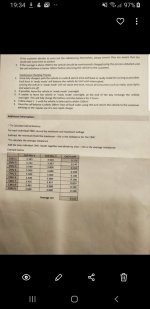

It is going to take you a long time to recover 24v from your current 425 to the new BMS maximum for your car which is 449v.
You will need to force your car to complete a full balance. I wasn't using my car much during lockdown but ran it down one blob on dash to around 83-85%. That way when I charged the car overnight it would fully charge and then automatically complete a balance/equalization to try and recover the cells to the same level.
You are probably only going to see a 1v rise every charge cycle so plan on getting 24 charges completed before seeing a range improvement. You may also find balance times take a long time to complete but in time they will improve to a more reasonable 2 hours from what you may be experiencing at the moment.
Search BMS on this site for more background and you will have an understanding of everyone's frustration with the faulty BMS of Late Oct-Dec 20.
MG accepted it was their fault and dealers were asked to give customers a free service for their inconvenience.
Worth asking your dealer for loan car whilst they charge it and resolve range issues as per my last screenshot of guidance issued by MG UK.

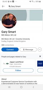

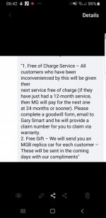

Hi m8,
The only name I have found was Gary Smart at MG. He was the Customer Service Manager at MG UK that dealers were to contact to get customers a free service following BMS update.
See screenshots for info

Have you shown the dealer the MG note about them giving Customer option to leave car for them to get car up to a balance charge over all 9 cells as per note?
I see that Eric Stead has very good feedback from members of this forum. I think it is worth an email to them with attachment note from MG to request formally that they rectify your imbalance and request a courtesy car whilst they sort yours out and get it to 449v fully charged and a balance time of 2 hours. After all they can claim costs back from MG.
