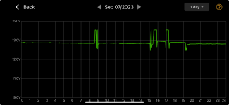

I can highly recommend a 12v battery monitor for peace of mind. Attaching a 'normal' day. In our last ZS EV MK2 hire we noticed the battery was not doing so well, but touch wood our current car is doing ok.
The only issue I noticed was with a Zappi v1 where the 12v seemed to have been draining when connected but not charging - the car warned me to start the car to charge the 12v.

You could install a 12 volt battery monitor ( See the video in #27 in this thread ).
This will monitor the batteries condition and you can monitor it yourself at anytime if you wish.
Also, it will send a notification to your phone, if the battery state drops below a safe working level.
Then you will have some recorded historical data / proof / data sorted on an App on your phone ?.
