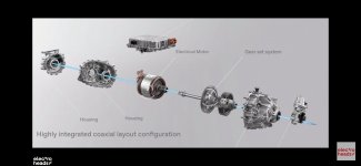

I have been wondering whether MG4 has 2 gears based on Johnny Smith's review where he says that it feels like it changes gears at around 40 mph and then there is this snippet, please see the attached file. I am not an expert by any means, just if someone knows anything it will be great to find out if this this is the case. I would imagine if there is a second gear the efficiency in high speed will be pretty good.

I doubt it. MG would've advertised this (like they do on the Marvel R) and I would have expected a much better WLTP range and/or much higher top speed.

I wonder if it's the electronics simulating what Johnny felt? It's possible to build in a change of output at a certain speed/throttle input without the actual need for a second gear.
It is very unlikely since only high end cars like Tycan's have 2 gears but I just got curious.
Even the Taycan only uses it on some models and on the front axle only.
I suspect that it was a fault rather than a deliberate feature. Having a change in the torque available is understandable but having that manifest itself as a hesitation doesn't sound right. Mind you, other cars are now built with false features (BMW i8 with external engine noise speakers to hide the 3 cylinder as a 8 cylinder comes to mind and a large number of sports hatchbacks with false internal engine noise) so anything is possible.
Interestingly, when we had the Marvel R we never could feel the second gear kick in, the change was imperceptable so I'd be surprised if, even if the MG4 did have 2 gears (unlikely) one would feel it select the second.

I'd say that 40 mi/h is about the start of field weakening. If they don't get the firmware just right, you would presumably be able to feel it. Getting that torque control just right is something that Nissan do very well, and possibly SAIC (or the third party writing the motor controller firmware) may take a while to get just right.

I do believe in the pod cast 19th August Miles said it was direct drive.
