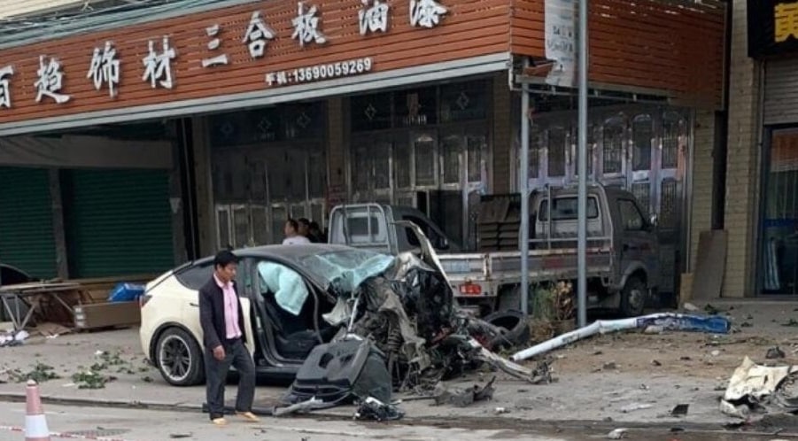

There is a video online of a model Y in China ‘taking off’ and going faster and faster until the driver loses control and crashes.
Two people killed.
We had an model Y taxi in Norway which crashed into a bar and kiosk. According to the driver the throttle got stuck. Someone filmed with the mobile and brake lights was on the whole time.
But the cause is still under investigation.
