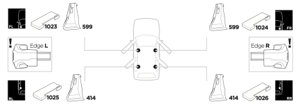

I think I've finally found a kit designed for our vehicle. Looks like this fitting kit will allow a standard Thule clamp + bars to fit our vehicle?
Fantastic! Thanks for the link! Where are they available for sale?
The suggestions on Thule's page that lists that PDF are either out of stock (Nautical Ventures) or only have a version rated to fit "...Mazda 3 4-Door Sedan or Mazda 3 5-Door Hatchback" (response from Peter Glenn Ski & Sports).
Got a previous Thule Evo wing assembly already, all I need is that fit kit, specifically, items #1023, #1024, #1025, #1026, #414 and #599 (see pix)

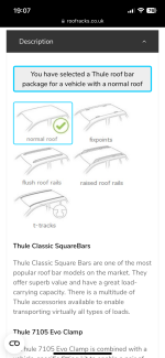

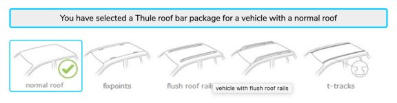

Hi. Thanks for sharing this. I’m keen to get for our excite. You said to choose ‘flat roof’ - is that the ‘normal roof’ option (see attached)
Yes, for the pre-facelifted MG5 Excite sans roof rails, "normal roof" is the one to choose.
