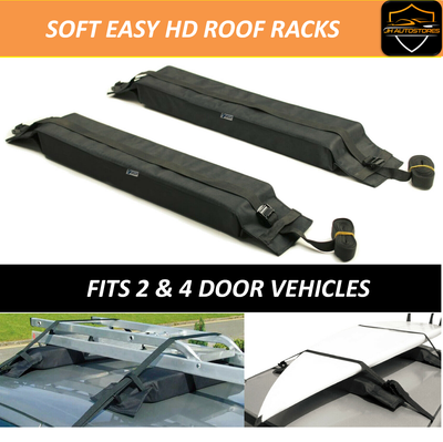

I know next to nothing about roof racks/bars/rails but this popped up on eBay, probably rubbish but thought I'd throw it in.
You should not use these in a car with curtain airbags as they prevent proper deployment of the airbag in the event of an accident
I know it's not the right answer but I've driven more years/miles without side curtain airbags than with them and thus would be prepared to take the risk, if I needed one.
I did not say the airbag would not deploy but could cause injury if restrained by the roofpad straps
