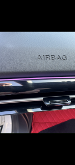

Im on my 3rd Ali express ambient lighting kit & honestly believe Ive finally cracked it. This kit is easy to install & boasts millions of colours & modes. Better still it looks “factory fitted”. You get 2 strips, one longer (passenger side) & a shorter strip for between the steering wheel & door. Behind the driver screen you will see a trim cover, carefully raise & remove it revealing 2 philips screws, remove these enabling you to move the screen out of your way. Now simply push in the strips along the dashboard inbetween the top of the gloss black trim & dashboard fake leather. The wire end should be at the steering wheel end. The screen move enables you to get right round the curve behind the screen. You are almost done !trim the long ends off with sharp scissors & seal ends with electrical tape before pushing in flush. Guide the 2 wire connections down past the screen & put the screen back. Connect them & plug into the usb. It lights up green 😎. The supplied remote needs a cr2032 battery however the instructions give you a link to a free ios/android app. Done ! You can adjust brightness, select any colour or have rainbows scans & god knows what, it will even react to music (if thats your thing). Best of all it looks factory fitted. You may have to power it on/off with the remote, just point it at the thingy plugged into the usb. My Wife loves hers & I love mine.

I spotted this post and have just managed to complete this and I have to say a big thanks for posting. As you say it looks totally OEM because you can loose all the wires down where the display is. Absolutely fantastic, thanks!

Honestly there isnt much to show! It simply connects to a usb adapter & plugs in. You push the strip into the gap (difficult as its tight), cut the excess off with sharp scissors & cap the end with plumbers tape then push into place. The only intuitive thing I did was remove the speedo to achieve a factory fit/finish. Standing outside the drivers side you will see a plastic cap behind it, use a plastic trim tool to pop it out & there are 2 philips screws. Lift the speedo out of the way, you can now get both strip end plugs to the left side of the steering column to plug in, and fit both strips flush. Anybody can fit this.

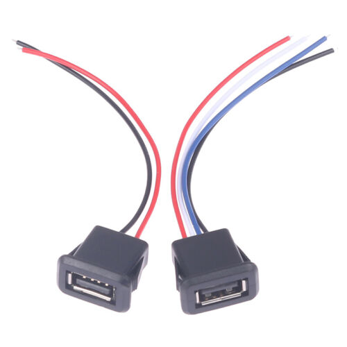

Thanks for that it looks realky good. I think i wil probably go for something like this and go straight to the fuse box as the usb is always in use for me.
Whats this for please? Unable to see accompanying post. Obviously I can see its a usb 2 replacement 👍
