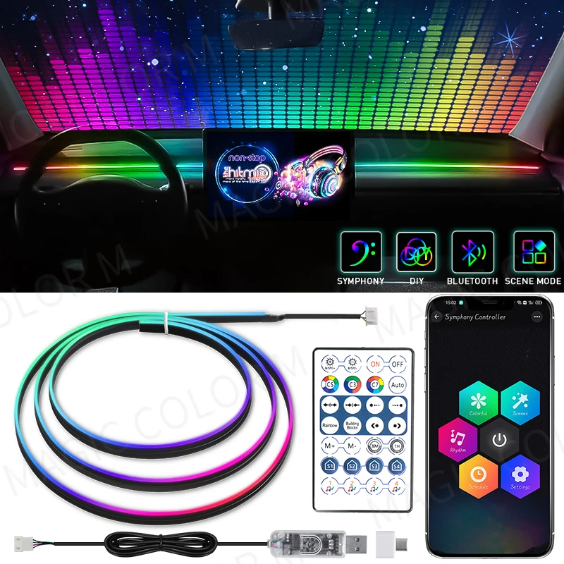

For hardwiring to a switched fuse in the fusebox rather than taking up a usb socket. The intention to wire to the same fuse as the dashcam so as soon as you get in the drivers seat the strips come on.
Not the exact one as you would probably need the 5v conversion type like a dashcam.

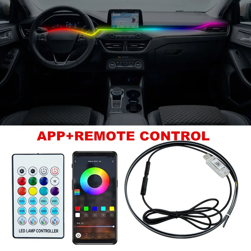

Im on my 3rd Ali express ambient lighting kit & honestly believe Ive finally cracked it. This kit is easy to install & boasts millions of colours & modes. Better still it looks “factory fitted”. You get 2 strips, one longer (passenger side) & a shorter strip for between the steering wheel & door. Behind the driver screen you will see a trim cover, carefully raise & remove it revealing 2 philips screws, remove these enabling you to move the screen out of your way. Now simply push in the strips along the dashboard inbetween the top of the gloss black trim & dashboard fake leather. The wire end should be at the steering wheel end. The screen move enables you to get right round the curve behind the screen. You are almost done !trim the long ends off with sharp scissors & seal ends with electrical tape before pushing in flush. Guide the 2 wire connections down past the screen & put the screen back. Connect them & plug into the usb. It lights up green ?. The supplied remote needs a cr2032 battery however the instructions give you a link to a free ios/android app. Done ! You can adjust brightness, select any colour or have rainbows scans & god knows what, it will even react to music (if thats your thing). Best of all it looks factory fitted. You may have to power it on/off with the remote, just point it at the thingy plugged into the usb. My Wife loves hers & I love mine.
