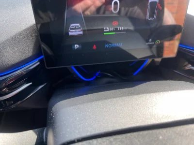

I have just done this, great idea but I’m not the best with cars or wires. I’ve got the screen back on and the lights in place but have quite a bit of wire behind the steering wheel/below screen. Can I cut this anywhere or tuck it down where the screen is when taken off? Attached pic below, so it’s just a little bit need to hide.
Also, do you have to use the remote or app? Noticed when unlock car they power on, but closing car and locked the lights were on so had to use the app to turn off. Any adapters etc that might work for this? Was thinking USB-C to standard USB

The strips come on with the key? I just put a USBc - USB2 multi adapter in my c socket. Unlock with key = strips light up & lock with key out they go.
Just a standard usbc-usb adaptor? Just got one from Amazon so hoping does the trick. Mine come on when open car but stay on after locking. Just using the standard usb
Might be worth seeing if they stay on after a few minutes. When locking the car, a lot of stuff stays active for a little while (if I walk past my phone automatically connects to CarPlay again for instance). Add to that that these LED strips can glow for a bit on “residual” power, it might just be that the lights will turn off with the car, but they take a few minutes to do so.
Think you’re right, cheers! They do take a few mins I think to go off. Got an adaptor anyway as need usb cable for car play too but should go off same way
