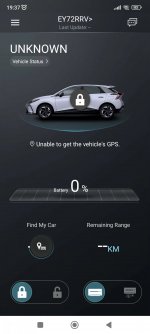

Once you've turned it on, press on the HVAC text and it'll allow you to adjust the temperature.
I just can't see it. Nowhere does it say HVAC 😞
