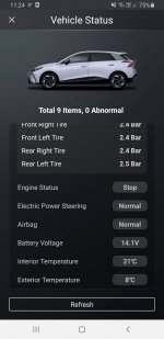

No wonder the blowers don't deal with fogging very well when it thinks it's a sauna in there.
Ambient temp now 8°c
Exterior read 8°c 👍
Interior read 21°c 🤔 (no sun, and it is genuinely cold in there)
Exterior read 8°c 👍
I do think the internal temperature sensor reads well above what it actually is, I think this also then causes the issue of having to set the climate much higher than necessary to get heat into the cabin.

I suspect there are issues with cabin temp sensors. I have reported fault to my dealer that I have to have my heating set at 26 degrees on cold days, anything less and it is bloody freezing. With temp set to 26 and after a 45 minute journey, if I check the thermometer I have in the car it'll show 20 to 21 degrees

Interior temp still way off at 9c above actual
