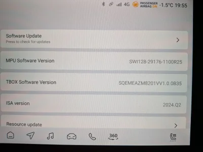

Just took a picture, it's still working, no lags or unresponsiveness. Can't tell what version I had before friday, didn't care since everything was fine. As I wrote, I did a factory reset, left the car alone overnight and did 10 sec restart on saturday. Since then it seems fine again.
I'll take a photo of that page before I leave it to its own devices on Starlink.
