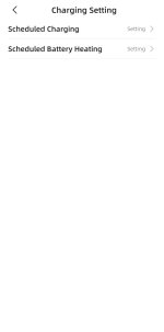

That is interesting. I think MG mk2 has a battery heater. In the MG app it suggests to use scheduled battery heating an hour before using the car.

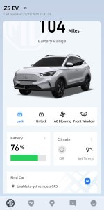

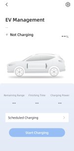

Really? I have a Jan '24 Trophy Connect and can't see such a setting in the app. I can start the window demister or the A/C but can't see anything about battery heater or even battery temperature.
Click on the battery button on main screen, takes you to another screen, on top right corner you will see a very tiny hexagon symbol, click on that you will see those options.
Not sure why the have made those hard to find.
Thanks for that - I'll use it in future when it's a cold morning.
