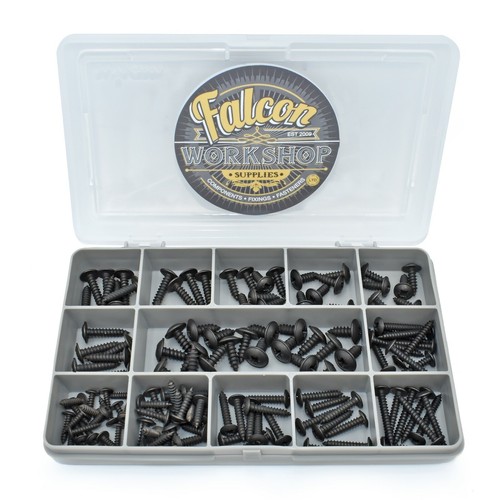

What about the set from EBay ?.
Various dia and lengths also, with the built in flange washers - ideal !.
This company also sells larger sets as well.
Just check you are happy with the sizes before ordering.
