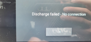

Hello,
I recently purchased an MG ZS EV LR Trophy Connect and attempted to use the V2L function. I tried various power states for the car, ensure it had decent charge etc however it refuses to start providing power.
I have ordered a different cable for testing purposes but I note that others face an identical issue.
As V2L was one of the motivating reasons for purchasing the car, I am now facing the prospect of returning it to the dealer. It was purchased around 21 days ago although I'm not clear on what constitutes the "purchase" date under consumer law as it could be the date I paid the cash, the date the docs were signed or the date I collected the vehicle (which was the earliest they were able to offer).
I have spoken to my local MG dealer who was not helpful - firstly sending me on a wild goose chase with MG directly, then advising they did not have a genuine MG v2l cable to test with and couldn't see me until the end of July. I wasn't expecting stellar service I suppose but this bordered on hostile.
Any suggestions/advice appreciated.
