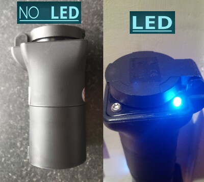

I've just got a cheap V2L plug from eBay which works well.

Then I built a V2L cable. I tied a 470 ohm resistor between PP and PE, and connected CP to PE, and it works ! We can see a lot information about those V2L cables : 'new ones' with a 2000 ohm resistor instead of 470 ohm, and also resistor between PP and CP instead of PP and PE. I haven't tried those yet.

Up to 9A (2200w)
That's the official capability with the MG V2L cable (2000 ohm resistor). Users have reported around 15A for short periods of time, perhaps tens of minutes. My wild guess is that this should be a comfortable limit for the hardware, but without monitoring temperatures etc it's really impossible to know. The hardware can obviously handle 32A in the other direction (charging), but maybe MG don't turn on water cooling for V2L, as you might be camping in a location where noise is not welcome.
The Type 2 connector can handle up to 63A, but the charging circuit is built for either 3x16A (11kW) or 1x28A (6.6kW) tops. I assume the internal wiring was designed with these limits in mind.
I wouldn't recommend going above 2.2kW on V2L except for very short spikes in demand.
