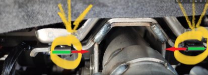

Steering noise ZS2: 3/10 hello MGs it's been a week since I made the modification, no more grip points or noise in the direction ???? the problem comes from the U-shaped washer which had to rub on the fixed frame ? intervention 10 min ? lower the steering wheel to the maximum low Remove the top cover of the steering wheel, it comes on its own A 13 mm flat key on the firm side inclined not the U Unscrew the 2 black screws of 1 cm Move the 2 U-shaped washers circled in red towards the direction Tighten and close everything ? enjoy
Thanks!!! I made the modification three days ago and solved the problem until now, moved both plates to the center of the steering shaft... Regards!!!
If you have any photos, please share
The photos are the same as shown on my reply post, but the one I have attached now shows in green the specific parts that have to be moved in the direction of the red arrows after slight unscrew both bolts. Then screwed back both bolts and thats it! Used the tool on the second fhoto the angle helps a lot to reach the ideal position to unscrew and screw it back. Regards

Hi! You only have to remove the plastic cover highlighted in the picture, but before, you have to lower the steering wheel the maximum you can, the plastic cover has no screws but it will stay stick to the car with a part made of synthetic leather. You can put the plastic cover over the dashboard (still attached to the synthetic leader) . For best access, I advise you to stick some adhesive tape on the plastic cover and attach to the dashboard. And yes is a 13mm spanner. Regards
Hello! Thanks for sharing your knowledge, can you please specify how much this "piece" should be moved in the direction of the red arrows? It's a like a minor adjustment to be "centered" or it have to be moved until it touches the iron on the side? Just to know when I open mine and try to do it myself :)
Hello! I moved the piece all the way that permitted... I think that the piece is shaped in U so for that it can´t go any further, if you look closely the U opening is on the direction of the arrows, if so, there is no way that it can reach the metal edge on the side.... Regards
Thank you!
I have just done the process as described by you and the fellow posters, and so far the clicking is fixed. :)
I did it like 5 days ago and drove around 400km so far, and the clicking hasn't returned. Likewise, I will keep you guys updated if it comes back in the future.
The process itself was pretty fast (around 20 minutes), mostly because I couldn't fit my hand really well in the gap even with the direction lowered at maximum, but it's manageable. One thing to keep in mind is to be careful of not dropping the flat key inside, I imagine it would be pretty hard to get it back.
