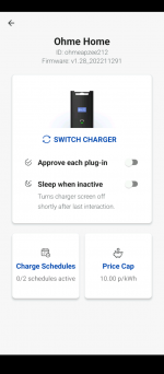

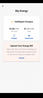

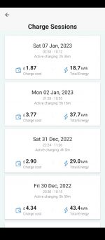

My Ohme charger configuration & price charged!
