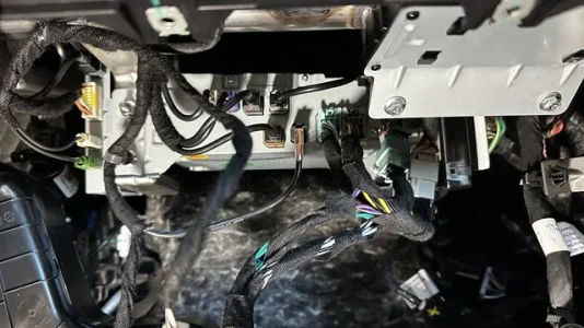

I'm struggling a bit with preparing for the install.
I think what I need to do is cut the RCA plugs off the cable that pioneer supply then "tap" them into the :
Left
  • White/Yellow
  • White/Brown
Right
  • White/Orange
  • White/Green
in your picture.
then black goes to earth, yellow to positive on battery... but where does the blue "remote" go?
**Edit: I dont have an amp. I'm just adding this to the system (well thats my intention anyway)
Left
  • White/Yellow
  • White/Brown
Right
  • White/Orange
  • White/Green
in your picture.
Hi.
I've attached the Pioneer TS-WX140DA Subwoofer manual, which shows the electrical installation.
The colors you mentioned are the audio outputs to the door speakers, you only need one channel since the subwoofer is mono.
There are two connection methods: one via RCA if your multimedia system has that "filtered" output (which isn't the case with our MG), or with a line cable +/- to a speaker, that's how I did it, those are the colors you mentioned and I marked them in the image.
My job is repairing PCBs, and I'm quite good at stripping wires and soldering with tin, a bit of heat-shrink tubing and it's perfect.
The workspace is a bit cramped, but with patience, it's easy. The most tedious part is routing the cables and removing the glove box the first time you're unsure how it all works.
The remote cable "blue" doesn't need to be connected, this subwoofer activates as soon as it recognizes an audio input and works very well. When I open the car door, I always hear the Welcome message, and when I close it, it automatically shuts off.
I don't have an amplifier either, I have more than enough power from what the vehicle delivers, but I was missing the subwoofer part.
I've also attached an image of the electrical installation I did.
*/ The audio diagram is for a Trophy model since it has front and rear speakers, but I think the colors are the same.
Let me know if you have any further questions.
