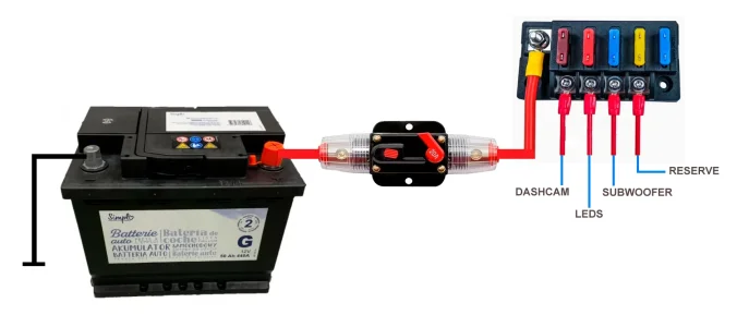

I installed this 4-unit fuse box in the same compartment as the vehicle's original fuses.
The subwoofer is powered by a 10A fuse, so that cable needs to be fairly long.
My fuse for the DSP and Sub is directly behind the 12V Battery terminal as I needed to route an extra 12V Battery connection.
Mine is also connected directly to the battery, but let's say that with that circuit breaker I isolate myself in case there is a problem with the "4 units" fuse holder that powers my things.
