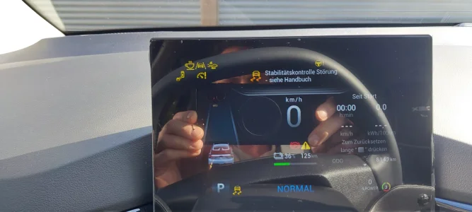

Went to vehicle today and got these lights which suggest parking issue.
Is there a fix or do I have call aa

Looks like you've hit the jackpot, you've scored more warning lights Than I've every seen .... I'd try the Microsoft first step method, shut down/reboot. Get out, lock the door, do a lap around the car (optional choice of words of encouragement can be expressed during this time) unlock the car, put your foot on the brake and see if you get a better result .....

Hold your horses.
I fixed it.
Please don't ask what I did. I just returned to vehicle and it worked !

I have seen this once with a MG4 that had a failed update for the fvcm (the laptop died within the update and the module had to be flashed as a replacement and therefore lost its calibration file):
A) Its going to fix it self (either look and unlock it or disconnect the 12v Battery) - which fixed it in this case here.
B) You have the recalibrate the module which has to be done via SIPS (or to put it in other words you have to visit a dealer).
(Car in the picture is not mine)

I find this happens when the auxiliary systems that feed the infotainment screen fail to properly boot - screen remains black.
It either resolves itself after a while because the system recognises the problem or I hold the home button down until the boot sequence starts and the warning symbols disappear.
