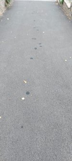

Had car 4 days 150 miles discovered oil leek as its all over my drive I took it back to garage straight away this morning they thought it was coming from the diff but it’s not they have kept car investigating, anyone else had this

Had car 4 days 150 miles discovered oil leek as its all over my drive I took it back to garage straight away this morning they thought it was coming from the diff but it’s not they have kept car investigating, anyone else had thisView attachment 11534
I noticed a wee spot this morning roughly where the rear nearside wheel would have been. Very small but will keep a close eye on it.
There hasn't been anything before that but it did it's first decent run yesterday.
We've had our sr since Saturday and I've just noticed some stain on our drive but it's more spread out done about 80 miles in it
Hi we have the same problem. The garage has looked at it and have kept the car. It is a leak from the motor and they need advice from MG on how to fix it. Ours is aTrophy with 200 on the clock.
I have car back apparently it was gearbox overfill at factory on another note I had a zs ev tropthy for the day couldn’t wait to get my .4 back imo it’s so much better

I was thinking that could be the case. It was either that or the filler/drain plug not tightened or, very unlikely due to the age of the car, a seal weeping.

Update from our dealer the leek on ours is further up on the motor they are waiting for mg to get back to them they tried the over fill no luck I bet there will be more out there
