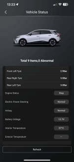

Just taken delivery of a MG4 Trophy. Delighted with the way it drives and getting used to being an EV owner. However I'm struggling to get the auto climate control set properly. I noticed the MG iSMART app reports internal and external temperatures which I assume are used by the climate control. The internal one is always higher than a reference sensor I put in the car and sometimes doesn't respond at all. It has just reported an interior temperature of 87c when it actually 24c. Has anyone else had similar problems? Many thanks

Anecdotally you need to set the target temperature in the AC 3-4°C higher than what you think for the heating to work properly. I set mine to 23°C and Auto fan and find it works fine.
If I get 87°C in the app I just scan the car again and it reverts to the correct temperature.

I have the same issue. I do not know if it is a faulty app function or an acutal sensor failure.
I guess the first, because if I rescan the car the temperature goes back to a plausible value.
But i also came to think that the phenomenom that I have to set the car temp 3-4 degerees higher might have to do with this whole topic.
