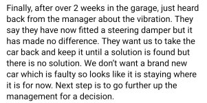

My dealer has booked me in for early Feb to get the dampers fitted. I don’t seem to have the issue too bad, but I’ll update later in Feb after testing it.
I don't know how well you get on with your dealer, but could you try and get a picture of this mystical damper?
Also I thought someone in Oz, who has had the "fix" already said it doesn't work?
I don't think there will ever be a solution peoples?
