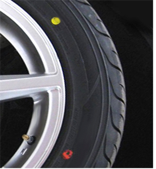

Do wheels and tyres not normally have markers that should be lined up?
It is my understanding? that some brands put a red dot on the tyre wall which is the "heavy" part of the tyre.
The fitter is then supposed to put this dot opposite the valve.
This is the first balancing step before any weights are added.
The red and yellow dots have different meanings, which you use depends if the wheel is marked or not...
Ah, nearly got it right ??
There is a spot but appears to be orange! Hopefully we may have an answer for some owners, with balancing. However whoever you use, they need to know what they are doing. I cannot fault Kwik Fit Wrexham for their efforts.
Of my 4 tyres (Bridgestones) only one had an orange spot on it! (was probably red at one point)
