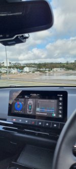

I've put on my energy consumption screen, I'm in normal mode (rear motor only) and when I'm decelerating I will see if both motors are used for re gen.

OK, so regen is done by rear motor only regardless of whether you are in Sport or not.
Surely MG have missed a trick there ?
Although both motors would probably be "too harsh" a re-gen?
