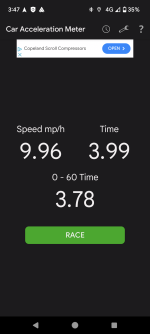

35% charge (it's a coincidence that my phone was also 35%), could only get 6s with ecs on, turned it off and got 3.78.
Does feel slower than higher battery though, my stomach didn't go over.
Strange how turning off traction control made a huge difference at low battery percentage??

I generally don't launch this and normally just drive sensible. But........ I've paid a premium for the sports model; it should perform as it was intended regardless of how I chose drive it. I believe I have an issue with the car, so trying to get it sorted. MG dealer say there is no issue, but if it can't get any where near the performance it should, then I would've gone for a different, cheaper model. I only bought this one as it was supposed to be quick.
So a few timed runs I've done. Granted, its only from the phone app, so they won't be 100% accurate.
I'm going to try and log a few more details, such as the mode, temp, esc and power availability.
The temp has been between 9 at the lowest and about 20 Celsius; 15 being around the normal for 80% of these runs.
Ignore the regen, I'm also noticing that my regen varies widely. Sometimes it works, others I need to get on the brakes.

It's better to film the speedo and time the video with a crono. Just play the video at 0.25x of speed so you can be more precise.
The speedo is on par with GPS. Take the time from 1 to 100.
I managed 4.0 sec at 65% charge. Sport ESC ON.
How do you film it? Its a bit hard on your own and trying to use the phone. I also don't want to get caught by police. Does track mode have any timing? From what I have seen there really isn't much use to it.
