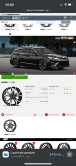

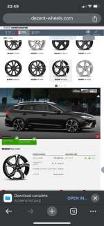

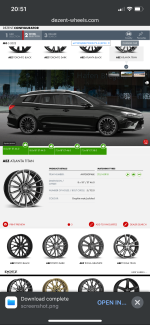

I’ve been looking at a springs plus replacing the wheels at some point. My only sticking point is getting wheels to be thin like the originals. Also as similar in weight.

That is sexy, do you have any more pictures?
And what wheels and suspension setup are you running?
That's a made up pic. But the wheels are 19s and it's on lowering springs. 🙂👍
What colours yours, what size wheel and style you thinking of ?
