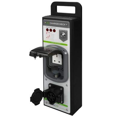

You can test with these
I'll check the model at work and find the model number.
Thats a unit for testing the wallbox which the OP has stated is working fine with other EV's and he has also tried the granny charger with the same result. It's a fault with the car not the wallboxes.
