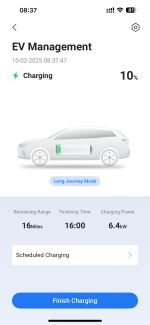

Balance day! Didn’t leave until 5.15pm
img_3546-png.34716
