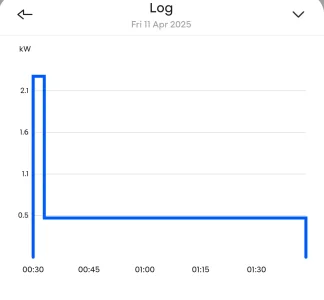

I just downloaded the log of the last charge. Car was at 100% anyway. This looks to me a lot like a balancing charge (at last!)
Will see what happens. The last service printout from the dealer said 98%. Will keep you posted!
It looks like the car successfully balances the cells in an hour and a bit.

For the record, I have noticed the same pattern on my Feb 2021 MG5 exclusive pfl. Can't say exactly when it changed. I have a Zappi 2.
Just the lack of the final v low charge, as seen on my myenergi app and shown on the original post.
