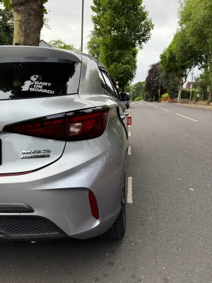

On the back i have a Darth Vadar baby on board.

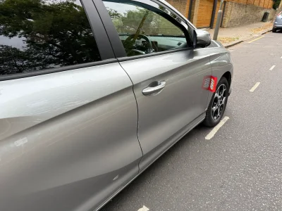

on the side, due to street parking, i wanted something that tell people to keep their distance when passing but not so serious, so i got a Lego tag.
There is also a "powered by the dark side" on the roof spoiler but it's sliver-on-sliver, so it's hard to capture on camera. only shows up when there is a headlight shines on it.

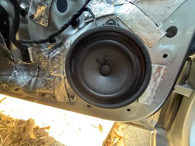

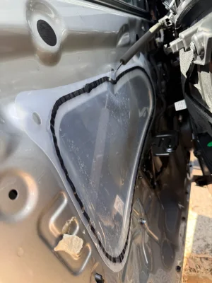

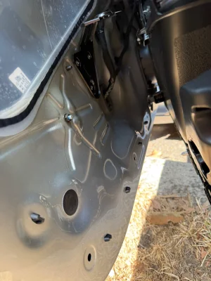

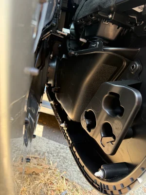

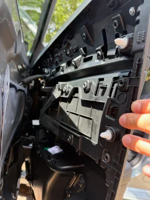

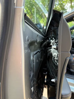

For those who interested in taking the car apart, i struggle to find good information, so i just went int blind. this is the passenger front door. as i modify, i will share more photos, may be helpful to some in the future.
For door card itself, go onto ebay and search for spare parts, they will have good shots.

I see you also have something on the back door (edge protector perhaps?), and something stuck on the rear bumper?, as well as something else sticking out of the boot?
yes. just some cheap/ soft rubber bumpers from amazon. Wife seems to be less careful with cars, but i guess when daughter is throwing a fuss, hard to keep everything perfect!
Does the door card just pop off ? are there screws too ?
there is one behind the door lever (inside), there is one more in the little "ash tray". both are under a cover, you can see where the screwe driver needs to place to pop that opens. One is a philip screw, the other is a hexagon bolt that need a 10mm socket. There are a few plastic clips along the edges running all the way to the bottom. The top it is "hanged" onto the interface with window, so undo the clips first then push upwards to release the door card. then there is a cable for window and door lock control, and then there is a metal cable that attach to door lever. both can be undone just using hands, no tool requires.
