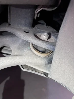

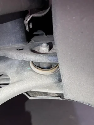

Just changed only right front lower swing arm front bushing by warranty on 50045 km
