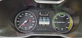

I'm seeing comments that battery need to be 450V after full charge. my car 1 month old showing only 439V. Is it a concern . I also learned that there is an upcoming update to fix the range misleading issue that I have. Is it going to fix the voltage reading as well?

just checked my voltage with radio on only and reading 405 volts is this right
What model do you have ?.
It makes a difference !.
I am going to guess either face lift ZS EV or MG5.
Both run on lower pack voltage than the previous Gen1 ZS EV.
Even the Gen1 model will run on two different voltages, depending on the BMS software version that the car is running on.
No standardisation here I am afraid ? !.

long range zs just charged overnight 100% left it plugged in for a good 6 hours not charging to balance and then checked saw 405 v

I am fairly sure that the new face lift ZS EV and the MG5 both run on 405 volts on the pack when fully charged.
