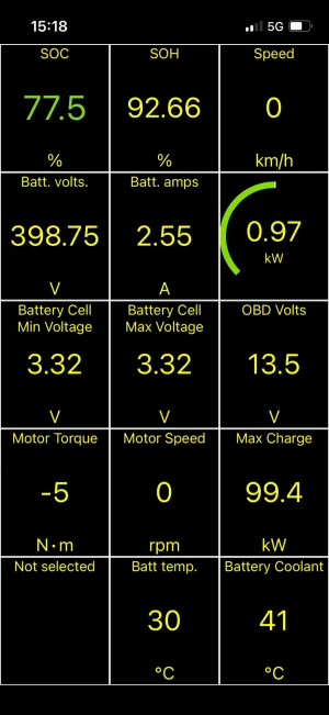

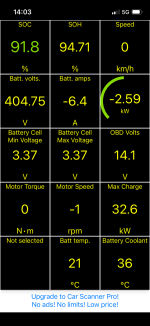

Using car scanner. Don’t do a regular check due to not ever having much cell differential. 95+% charged off rooftop pv so < 4kW. Generally only charge to 80-90% to avoid overheating in Perth weather and to avoid diminishment of kers at 95%. Will try to interrogate software tomorrow.

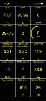

Btw my max/min cells exactly equal again/still.

Regarding cell voltages: even my unbalanced pack will show a similar minimal discrepancy between cells when the pack is somewhere in the middle of the SOC range (say between 10 and 90%). The only reason I still see any difference at all is that I get an extra digit (3 decimals), while the app only shows you 2 digits. You would not see a 3mV difference, it gets rounded to the save value.

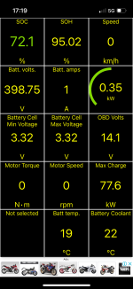

The very first screenshot you posted, where you had 99.9% SOC was 3.35V. The one just now, 77% SOC shows 3.32V. You had another one, 72% SOC, also 3.32V. The difference is very small, and most of that voltage drop will happen in the first 1% of discharging, when what is called 'surface charge' is used.
