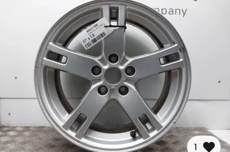

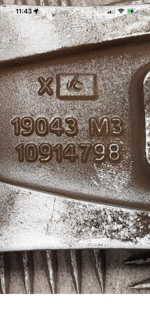

Rather than a new thread I’ve dug out this old one, can anyone confirm ALL EV ZS are 5x112 - in particular factory alloy part number 10914798?
Most breakers in eBay are using conflicting 100/112 pcd on both ICE and EV ZS! I’m looking to up my PFL5 to 17’s.
Also are the TPMS interchangeable (notwithstanding coding)
Thank you in advance!
