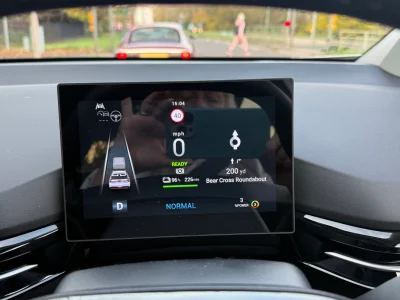

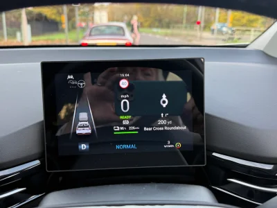

I have just purchased a brand new MG 4 Trophy. A couple of weird things are happening:
1/ it doesn’t seem to pick up different road speeds and is stuck on 30mph regardless of the actual speed limit. I have taken of the warning but I get a beep with a picture of a pedal and for saying slow down
2/ when navigation is on and showing on small display behind steering wheel the graphic shows the car to go the wrong way round a roundabout. The main map is correct but not the heads up display.
Has anyone any ideas before I take it back to the dealer.
Thanks
Welcome to the forum @girl on the heill , it looks as if your navigation thinks you're in a country where they drive on the right hand side of the road, but I have no idea why it should do it, or how to remedy it.
Just checked my driver's display and it showed the correct direction around a roundabout. It wasn't at a lane indicating location so I'll have to look for one of those. But my SatNav is probably an earlier version of the one the OP has given my car has not had any non-campaign updates.
Just a couple of questions, you said the speed recognition always shows 30mph but in your pictures it is showing 40mph? The speed recognition initially uses map data until the camera recognises any speed sign. So if your map data is corrupted (or set to the wrong country) this may be why your speed recognition is not working.
Does the centre map display also indicate the wrong way around rounabouts or is it just the display behind the steering wheel?
Also check everything is set to miles and not km as per point 9 below
