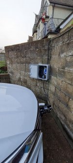

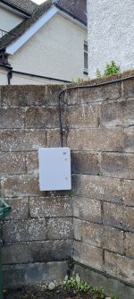

I also fit 32 amps charging box at home, I didn't use any of the wallboxes but bought Portable, variable 8-32A Charger which i placed in a plastic enclosure on my drive, total cost under £300.

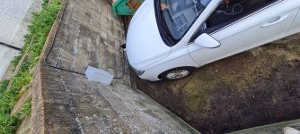

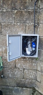

Sure, here it goes:
(And some pics of the install)
The charger has a variable current setting 8-32amps and a delay start so i can set it up to start charging with my night tariff (obviously no app though...)

Very neat, I looked at something similar myself as I wanted the 32a commando but unfortunately I couldn't get any with a 10m lead.
Do you have an earth rod or pen fault detection device?

I'm not too sure. I prepared the install, run the cables, install the box and the charger etc, but I had a friendly sparky that made the connection to the distribution board, so I don't know all the ins and outs.
Hi, that just like my OHME £200 from Octopus Energy.
The unit should have a pen device installed

£200 is a very good offer! Coming back to the connection etc, this electrician friend of mine is quite good, so I'm certain he did everything in accordance to the regulations.
At that price it was just to wire your commando up not to install any pen protection worth giving him a call as it is a new addition to the 18th edition regulations.
