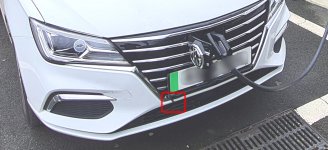

Interested in the access to fit the front parking sensors ( I do miss them in tight spaces)
Looking underneath the bumper I see that it is well panelled over or is there reasonable access from above with the removal of the cover behind the slam panel?
I run the cables just below the registration plate into the motor bay, and then undernath the car to the fog light, so the sensors can be activated with the fog light switch. I'll try to take some pictures tomorrow and post them on the forum.
I managed to find a photo:
