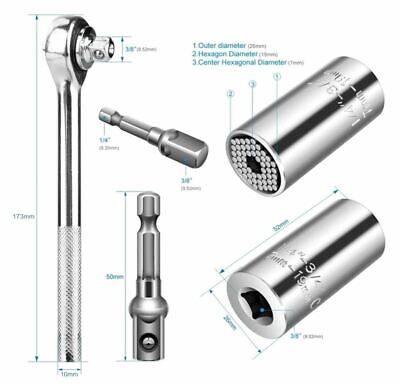

If the car has indeed got locking wheel bolts fitted and you are unable to find the master key socket to remove them, there are tools on the market that can be used to to get the locking wheel bolts removed.
Indeed, which completely defeats the point of having them in the first place.
