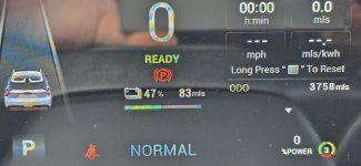

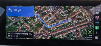

I use ABRP, it works really well and the OBD on/off button stops the alarm going off...along as you remember.
