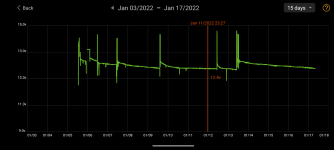

Hi all,
I recently fitted my Bluetooth BM2 battery monitor to the ZS EV just to get an idea of what the SOC was over time as I am currently not using the car every day.
It had been sitting for a few days when I fitted it and I was surprised it was low at 47%. The car is just over a year old.
Anyway I can confirm that once charged it runs down to around 50% in 5 days. Either my battery is failing or there is a drain, which I will check into when time allows.
Possibly the car sat for some time before I bought it, lead acid batteries get sulphate build up if allowed to go below 50%.
Charging does occur when the traction battery is on charge.
Thought I'd share as the battery monitor gives good information and is relatively cheap.

50% in 5 days does sound excessive.
If that battery was on an ICE car it wouldn't start, definitely something not right there. 🤔
Hi,
Thanks for your replies. The monitor takes very little (measured to be sure). It was also on my previous car for sometime without issues, even during lockdown.
I suspect a combination of some drain, the colder weather and a tired battery.
As mentioned if it were ice it wouldn't start.
Glad I know.
I do like the monitor though!
Thanks again and keep you posted.
