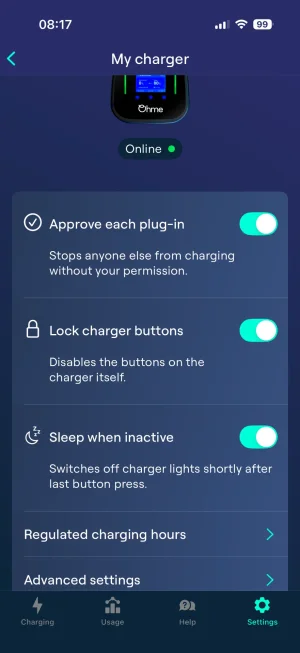

Hmm. I haven't changed anything since it was set up by the installer in August 2023.
How do I even do that?
Should be under:
Settings
My Charger
Check that the unit is connected (top right green dot, red or amber if not connected). I had to phone up Ohme for similar problem which was down to sim card losing connection, they did an update and I restarted, now working fine.
You should try turning off power to unit for 15 minutes, turn back on and see if this fixes issue first.

It sounds more like the OP has lost the connection to Ohme/Octopus so it’s gone into boost charge which it will do if it loses connection. I don’t use the authorisation feature but mine has gone to boost charge when offline.
I’d suggest trying again and seeing what happens. It may have temporary gone offline (it’s online in the screenshot). If not then look up how to restart the charger.
