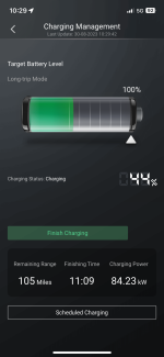

I had an update to my charge module the other week at my local (Seaford) MG garage. Previously I was unable to use Tesla. On Wednesday I went to Dorking to try again and Hurahh it works. Plugged in, started on the app and hey presto 85kW. Now I can plan Tesla site into my trips.
That’s great from your picture I see a MG5 facelifted model as is mine so you say update to your charge module have you any more information about this, did you request this or did you dealer tell you that was why it wouldn’t charge on Tesla before this was done, if so that appears to be the problem, and was there any charge made for the update many thanks in advance.

I called them to ask about an issue I was having with my radio reception being rubbish and CarPlay acting up and run my plate through the system and it showed 4 updates 1 was for the charge module that was on a campaign for known issues with some chargers. I mentioned it didn’t work with Teslas but he didn’t know anything about issues with them. I just tried charging at a supercharger again just to see if it sorted it. There was no charge for doing the update.

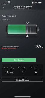

So CCU update was done but annoyingly no paperwork issued to see what version it is now - drove to Uxbridge Superchargers but couldn't actually try it as the Tesla app refused to accept my postcode as being valid for my payment card details (tried through the website aswell as I already had Tesla account but same problem ! :-( ... is logged with Tesla Customer Experience Team and waiting for them to get back to me ... so limped home for an off-peak Octopus Flux 25% top-up tonight !
Messaged MG customer service about the update needed to my zs EV LR (dec 22) so it can use open Tesla stations. Apparently MG regard this as a 'comfort' update and therefore it will be chargeable. I've asked them to explain why using chargers that are available to others is not a fault. Honestly such measley aftercare really makes me despair of MG
After deleting and re-registering my Tesla account (apparently you can change all the details apart from the country which obviously sets the details for subsequent registration fields) I got my payment card established - went back to the Uxbridge 'open' superchargers and no joy ... I setup a charging session OK but got an abnormal charge status message on the iSmart app and dash display, tried again and it connected but just didn't charge ... so the SA/SC052 CCU update isn't enough by itself ... back to MG to see why they haven't answered my email from 3 weeks ago and again try and get the exact wording of this software pack/'comfort upgrade' to get it installed ...
These are the errors I got before the update. The Tesla app kept saying ‘No Car found’.
